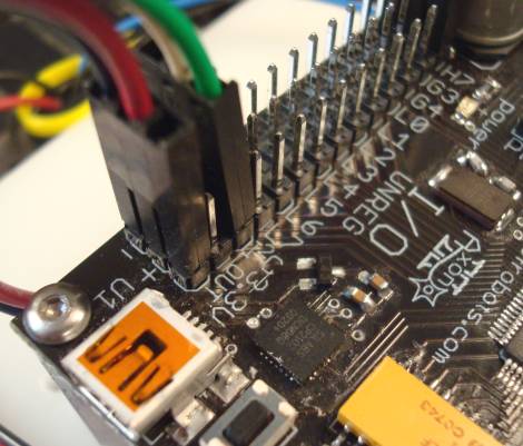

STEP 1: Install USB Drivers To use the USB for the first time you must first install the USB driver file. Simply download the .exe file appropriate for your operating system and install it. Next, plug in your USB cable (you do not need to power the Axon II to do this).
Your computer should now detect the new hardware and ask you about drivers for the CP2102 (the USB converter chip on the Axon). Follow the installer directions given until complete.

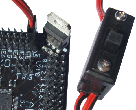

STEP 2: Connect Power Now you must plug in your battery. Look for the pin labeled 'Bat' on your Axon II at the top-left side. The middle pin is always for power, and the outside pin is always for ground. A 6V NiMh battery with Hitec connector is recommended, but you can also use 7.2V and/or a NiCad battery type. Be aware that most servos will over heat at greater than 6V. See the Axon II datasheet for more info on voltage/current tolerances.

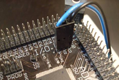

STEP 5: Connect UART The UART is a way for the Axon II to communicate with other hardware through serial, such as a camera, bluetooth, or GPS. It's as easy as plug and play. T is for transmit, R is for receive, and G is for ground (make sure external devices share a common ground!).
There are four total available UART ports, but the USB uses one of them.

STEP 7: Mount the On/Off Switch The included on/off switch has a plate that can be removed to help you mount it to your robot in an easy to reach location.
Here is an example of it mounted to the ERP:
